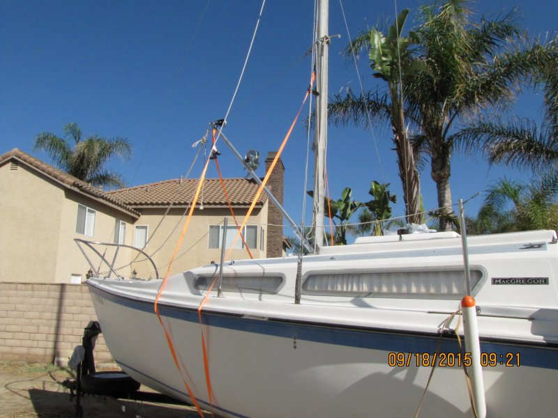

Mast raising system
posted 09-18-2015 by west wind
Click for larger view
Made this system for approx. $100, worked perfectly, was surprised how easily it operated, no effort at all to crank it up.no more waiting for help.
doesnt weigh much more than 34-40lbs.
The straps are 12ft long and are anchored to the trailer, I didnt want to drill any more holes on the deck.
Thanks for looking. I am 74years old and have been sailing since I was 10 years old, now retired.
